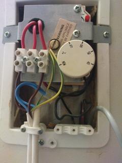

On left is cable in from live feed to solar pump run through cylinder's normal stat and overheat stat and out to plate exchanger zone valve (and via that to grundfos pump pictured but not used as gravity dissipates sufficient heat)
