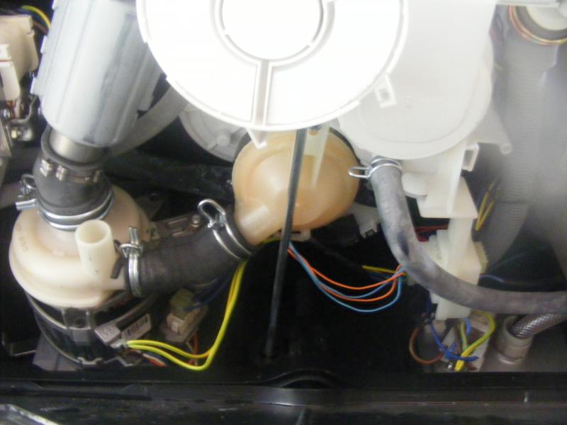

yellowish dead centre is the alternate valve.To remove you'll need grips (to open up the spring clips by squeezing them together).\none small phillips screw driver ( to remove the one small screw securing it to the machine).
alternate Valve Smeg
