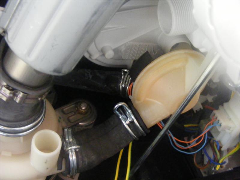

This is the alternate valve slightly yellow.You can see the 2 hoses one from the pump and the other up behind to the top rotor arm.the connector plug is off to the right and you can see the top tube on it that fits into the lower rotor arm.you mat need to move the thin metal bar by slightly bending it to get the unit out.
