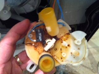

after removal of plastic plate and the cogs that are inside it- microswitch is box at left- you can gently turn the cog at centre and it opens the microswitch
smeg parts alternate valve
