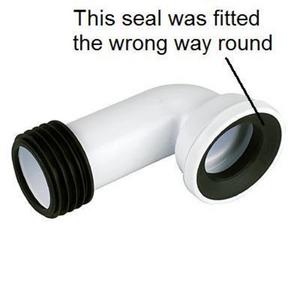

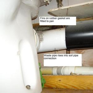

This photograph shows how the waste pipe is rising into the soil pipe connection. It also shows the fitting of the gasket between pan and waste (the finned end is connected to the pan).
