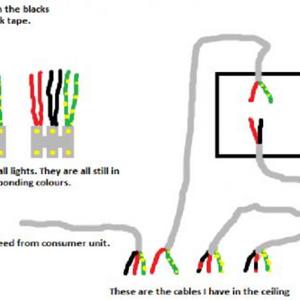

    Help needed with lights in lounge
    Does this help?
  3. 1
    I already know where the majority of the cables run to. One of the cables in the ceiling is the mains live, (from the consumer unit) the single red wire and earth runs to the switch, i have found the switch live running to the other switch but I was unable to identify the other cables in the...
  4. 1
    What am I supposed to be testing for by doing this? What will this tell me?
  5. 1
    Yes, sorry I should have been clearer. When the cables in the ceiling were wired up in what I assumed was the correct way (red to red, earth to earth and black to black apart from the switch live I found that there was continuity between all lights when the wires are not connected to anything...
  6. 1
    Yes, the single cable and earth is a single cable, not twin and earth with black cut off. There is 4 wall lights in total, these are all joined by blocks red to red black to black and earth to earth some are joining sets of 3 some are sets of 2 and some are single. There is continuity between...
  7. 1
    hi, you should be able to click on it to enlarge it
  8. 1
    Hi, i just bought a repossessed house and allot of the sockets, switches and ceiling roses were missing. I have managed to replace most of the sockets and switches, but the lights in the lounge have confused me. I Believe its a 2 way light circuit. There are also several wall lights on the same...
