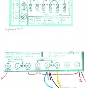

    On the front of the fire, behind the plate there is a light, when it is red or flashing red it needs to be reset. to do this one turns the thermostat knob to the off position and wait until the light shows orange. Then turn the knob to required setting and the boiler commences the ignition sequence
  2. 1
    central heating programmer replacement
    Hi Can anyone help me with a central heating problem? The Baxi back boiler kept cutting out and needed to be reset. A friend (installation engineer) told me he thought that the programmer was faulty as current was not getting through. As I had a spare he suggested I swap it in and see if it...
