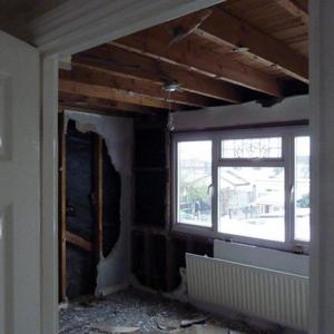

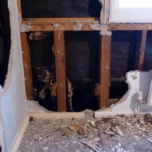

    insulation question - first house
    Thanks Deluks,, Here are some new pics. I will use Knauf FrameTherm Slab 38 against wall to stud then Celotex GA4000 Insulation Board up to the plaster board. I will tape the celotex to the timber with foil and use foil backed PB. With the celing does this sound ok 'Rockwool Roll Loft...
    Hi there, Am I correct saying I will use this stuff up too the stud beams then use Celotex up too the plasterboard. Also is that stuff ok to use on the celing? Thanks for advice
    Thanks for advice, My plan is this. 1. Celotex from brickwork to stud 2. then fill the rest up to where the plaster will go with fibre quilt. 3. Use polythene plastic to cover the entire lot. 4. use foil backed plasterboard But before all this im stripping and getting electrics sorted...
    Hi again woody, thanks for reply. I'm sorry to ask but what do you mean studs. Sorry for such a noob question. Am i correct saying, 1. Fibre quilt against the brickwork all the way to the wooded beams 2. from the wooden beam to the plasterboard use celotex 3. then use polythene sheet...
