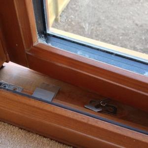

    Upstairs windows - risk of falling
    Hi guys, Thanks again for all your contributions, much appreciated. Just to update you, I have spoken with the builders and they have agreed to put an extra catch restrictor on the top of the windows, which should be resolve any safety issues. Adam.
    Hi guys, Thanks for your continued thoughts on the windows, its really appreciated. One of the windows upstairs is straight off the floor and is 1100mm in height. All of the others in every room at 200mm of the floor and rise to 1400mm in height. Would I need to pay for a building...
    Thanks Gazman for your reply. I have just taken some pictures. Hopefully if I have uploaded them correctly you will be able to see them below. If not they are on the following link: http://www.diynot.com/network/adamburton/albums/24778 thanks, Adam.

  13. A
    Hi, I wonder if anybody could provide any advice. We have recently moved into a new house (new build). All the windows upstairs are either full length right down to the carpet, or around 20cm from the carpet. None of these windows have key locks, but upon opening each of them has...
