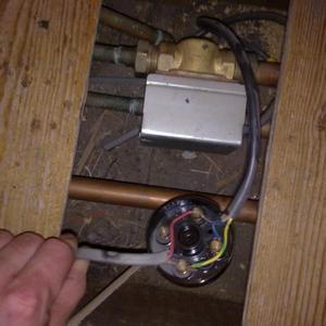

    Hey all, Thank you very much for your time and help. It was the 2-port motorised valve, it wasn't powered so the valve was shut blocking the system, this is now sorted and all the heating works perfectly (thank god!) Once again thanks, Kind regards Ashley

    All I need to know now is.. Do I connect the cable coming from the JB at the motor valve to the new white JB and then connect the thermostat into the JB as well or just leave the thermostat our completly... Ash

    http://www.flickr.com/photos/ashleycowx/5187814178/ The pipe going under the silver box does NOT run through it... This juction box with T+E coming out is what I took out of the programmer me thinks.... Does this cable need to go into the junction box...

    Hey all, thanks for your replys, after looking at the pipe work there is a motorised valve on the system. When i ripped the old thermostat out there was a cable looping into the old programmer (timer). So there was 4 cables in the old programmer 2 just power to activate the boiler, 1...
