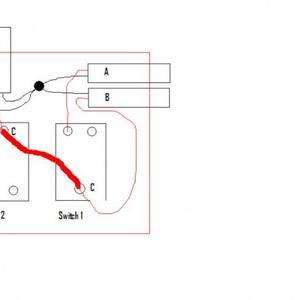

    Twin circuits but all through one?
    ... ColJack. Thanks, you got it spot on. My assumption about there being two pairs was wrong. It was one live in and 3 switched lives out. And I had not wired the one permanent wire to Com in switch 1. Once all the wiring was re-ordered, I now have ceiling lights controlled by one dimmer, and...
  2. A
    Thanks for all suggestions. Will try them out tonight. Yes they are dimmer switches. I left this tidbit out as I thought it wasn't relevant. Each dimmer is rated at 450W. Alan
  3. A
    Apologies if the title confuses the issue even further, but here is my situation: My house is less than 10 years old and wiring seems to be OK. In my lounge I have a double wall switch. I also have two ceiling lights and wall plates hiding wiring for 3 wall lights. Assumption then is that...
