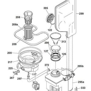

    Ah, there it is! - behind the right hand front panel... The service manual refers to is as a "water softener capacitor". However, I can't see a "flow meter" - there are no electrical items attached - it's just a plastic tank. There, is, however, an electrical connection...

    Candy CDI 1012 service manual p6
