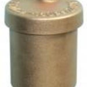

    Heating Problem - Potterton Boiler - Micro Bore System
    Yesterday, I fitted a Primaflow 3/8” Air Eliminator (automatic bleed valve). Completely drained the system, flushed with fresh water and refilled. Pumped the system without the boiler switched on. Bled each radiator in turn, starting at the bottom radiator. Then opened the...
