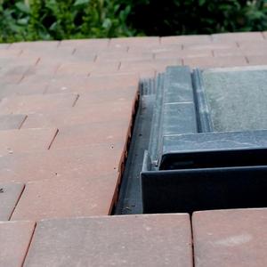

    Is this normal? Tiles around velux look messy
    I double checked with another builder and he said it's 17 degrees. Maybe the photo is deceptive? Unfortunately we can't change the tiles now so it is what it is, is there any way the will function properly and look nice? The sandtoft website says they are guaranteed till 15 degrees. Will it...
    Oh I see, thanks for the input. Datarebal I have measured the tiles on page 2 and posted pictures, any thoughs? Thanks in advance.
    Ok thanks. So the tile is correct for the pitch, the flashing is correct so will it look nice when it's pointed and finished? Does it just need trimming?
    Thanks for the photo! Yeah those look like they are sitting nicely. Is this a different type of flashing than we have?
    Yes those are the ones! I found the link here. It says it can go down to 15 degree pitch which is a relief. I found out our pitch is about 17 degrees. http://www.sandtoft.co.uk/tiles/our-products/natural-clay-range/plain-tiles/2020/product/ I went out of the top window above and measured the...
    Ah ok not new ones then huh? What do you recommend out next step should be? Thanks.
    Hi everyone, I decided to mention something to him on Friday and he said that the roof is not finished yet and that they will pin them down properly after we have finished painting the outside of the house in case any break. Now my question is, could they ever look good with that flashing...
    Hi, No they had not ordered the tiles or the windows yet. They brought us one concrete sample which we thought was too large as it was huge compared to our roof tiles. So we asked if we could have something smaller and then he brought us a sample of the ones that we eventually used. They said...
    Hi, Thanks very much for your replies, I was afraid this was going to be the answer. Not sure what the pitch is, will have to ask my husband. Basically they were going to use the large concrete ones but we didn't like the look of them so they brought these as an alternative. Is this a big...
    Hi there, I was wondering if someone could take a look and let me know if this is normal. I know the tiles are supposed to kick up abit by the windows but it seems they are not sitting quite right. The roofer said that it's done like this in order to be insulated well. Is there anything that...
