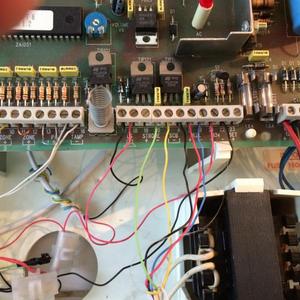

    photos of concept 6 original installation. latter photos are of concept 6 laid out on kitchen worktops and rewired for testing. and it works ;-) note that the original installation used 8 core cable which i used to install the new Gen4 alarm and worktop test used 6 core...

    hi.. thanks for that info. can't see aux on the concept 6 pcb though...have to cancel my plans today and get on it tomorrow. i have too many people here today so would be awkward. i have some pics of the pcb. i'll upload later. thanks again sparkymarka. as always, your advice is appreciated. AG.

    link to the pics. http://www.diynot.com/network/Ancientguy/albums/21781 the way i read the diagrams etc. it would seem that if i make the power connections from the alarm panel J3 13V + and 0'v to the dialer power connections 12V red. 0v black and then take another wire say blue for...
