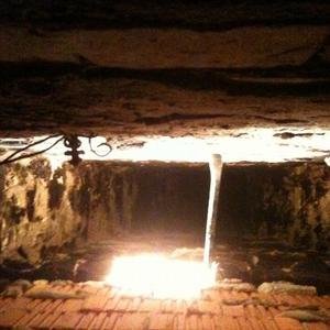

    Opening a Fireplace
    Hi All, A little update on the weekend's work. With some help from a bricklayer friend, we've got the lintel in, and the arch rebuilt using the bricks below as a former - this seemed easier than opening up the fireplace straight away and then having to make a wooden former to build the arch...

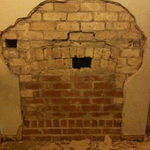

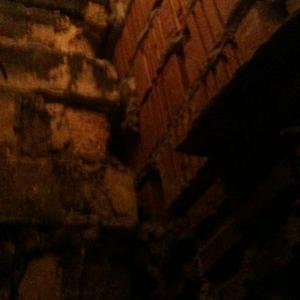

  5. A
    Opening a Fireplace
    Right, I've been busy with the chisel again, and I've taken some more plaster off. It's now clear from the photo below that there is no other lintel above the arch: It's also clear that the arch has slipped at some point and and is no longer supporting anything. The new hole on the left...
