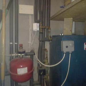

  3. Untitled
  4. A
    Banging from Motorised Valve
    here ya go: Excuse the dog hairs that have gathered round everything! Really must pull ev thing out and clear it all down.

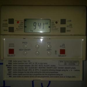

  8. A
    Tried setting pump to all settings 1,2 and 3 and the banging occurs on all 3. The fact that the banging stops when the HW is switched on and after the motorised valve moves position surely indicates that something is faulty either with the motorised valve head (part HSA3) or the valve...

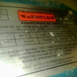

  10. A
    Heres an image showing the plate on the boiler and its make and model info The pump is set to "2". Have also tried it on one. Havent tried three yet as two was very noisy. There are no thermostatic valves on the radiators Not sure if there is an automatic bypass on the boiler, how...

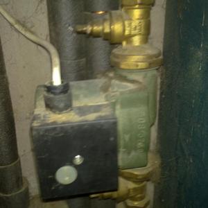

  12. A
    Hi, thanks for your reply. Port A is connected to the CH and Port B to the HW. I cant spot a make on the valve but its model number is HSV3, see photo below: Any further advice very much appreciated. Andy
