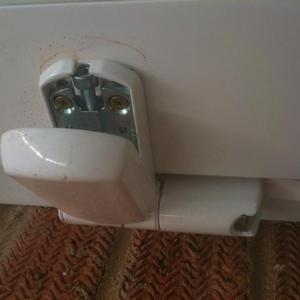

    Door not fitting
    We'll I believe its properly toe and heeled. Any guidance there? The hinge has two allen bolts, but neither move the door upwards.
  2. A
    Door not fitting
    Yep did that, adding packing bottom side (hinges) and top side (lock). The door sits on pins so you can lift it off the hinges, tried adding washers to these pins which raised the door but knocked out the lock alignment even more
  3. A
    Door not fitting
    Hi, I’m in the midst of fitting a new conservatory. All going well up until the point that I’m trying to fit the door. I added the glazing into the door, however it will not shut as the bolts are not clearing the locking mechanism. The hinges themselves do not appear to have vertical...
