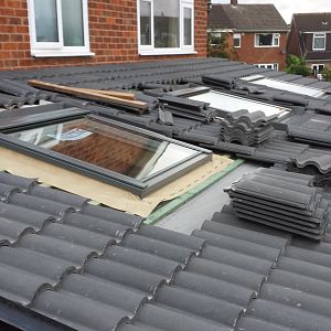

    Low pitch roof
    In the end I didnt bother to try and raise the top end of the velux windows as it was distorting the EDW flash kit too much. Also it didnt make any difference to the bottom end of the flash kit where there was potential for puddling. At 12.5° the roof and windows have been in for about 7 months...

    Low pitch roof
    Yes, my thoughts too. Although it's pain it shouldn't take me too long to revert the 1st window back to it's normal plane. Taking extra care in the corners of the flash kit below the window. Unfortunately I think a small amount of puddling on the corrugated flashing is unavoidable, but...
  11. A
    Low pitch roof
    Worked on the roof today finishing off the window that has a 25mm upstand on the top edge. Had to deform the flashing in a few places but nothing too drastic. All finished off & sprayed with water for a few minutes and all looked OK. Started on 2nd window but noticed it puddling slightly on the...
  12. A
    Low pitch roof
    Bottom course is OK. I've moved the tiles up temporarily to remove the eaves protectors that were put on wrong. The roof never really got designed from scratch. Neighbour has the same size rear extension and his dwg stated 15°. I copied his drawings and kept the extension the same size to...
  13. A
    Low pitch roof
    Halfway through doing the low pitch roof. Employed a roofer to complete the job over 3 days but unfortunately he walked out after I a few disagreements. Oh Well. Anyway main roof is 12.5°. The tiles are redland regent with at least 100mm overlap so should be OK. Also installing the keylite...
  14. A
    Low pitch roof
    why would 20 deg be the min when both velux & keylite guarantee at 15 deg?
