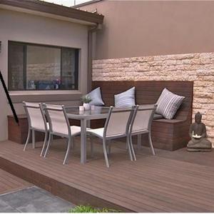

    Garden patio revamp idea
    ha...Imagine if it did. So i guess i'll have to think about that. Would the walls not collect water where it meets with the seating?
    Hi guys, I'm getting stuck in to clearing my garden its about 12 by 40 feet terrace. I wanted to put decking down and then some seating made from oak floorboards that i have (obviously treating them first). I'm worrying about damp? See the pic. I was thinking that i should treat the...

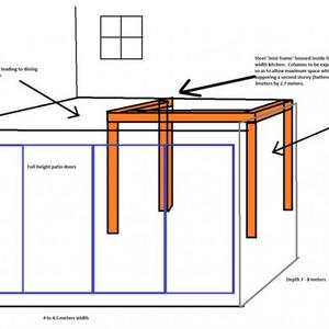

    Need ideas on 2 storey extension..
    thanks for the lovely motivation. i think there is a slight misunderstanding. Currently i have a 50 foot garden which isnt over looked. The kitchen currently extends out by 5.5 meters. My lovely neighbour (landlord) extended out by a further 3 meters or so. So the full length is 8...
    I am likely to get PP so long as the design and material used is of high quality. Also there is 2.5 meter wall on both sides of the kitchen, so neighbours cannot really complain. Especially as the left side has a Lean to which was built by the neighbour with the previous owner. I ws just...
    Hi I need some basic advice for a project i would like to embark on next year. please let me know your thoughts. I live in a 2 up 2 down terraced house with the kitchen and loo at the back. I also have a lean to on the side return. I would like to extend into the lean to and put...
