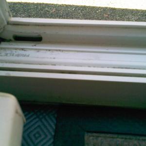

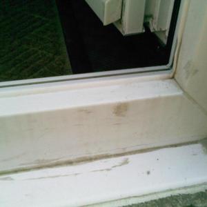

    Drilling drainage holes in UPVC door frame
    I've had problems with rain water accumulating in the frame of a door. From what I can see, there are drainage holes in the top of the frame, but none elsewhere to drain the water. Sorry about the quality of the photos, but you can see that there's no drainage on the outside. I can...
