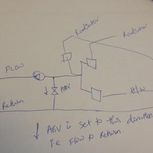

    S plan fully pumped boiler switch off every 2-3 minutes
    Hello all thanks very much for help specially Mogget. I managed to source out the root cause....it turned out that ABV is faulty. I.e. it was not closed properly and water was pumped back to boiler before it reach to radiators!! I have ordered Mayson this time Honeywell has been returned. I have...
    Boiler switch off every 2-3 minutes. Advise needed please, below is system speciffication System is fully pumped S plan 3 zone with Honeywell Auto-bypass valve following are the specification. Boiler: British Gas 330 Pump: Grundfos Pump Valve: 2 into Honeywell 22mm 2Port valve &1...

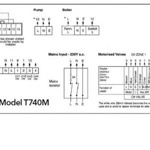

    S plan Pump overrun wiring help required
    Just to confirm that I have made wiring as per Hailsham instruction and everything working treat!!! So far no sound from boile I see pump is running after boiler stop supplying heat! Thank very much for your help guys!!!
    Thanks D_Hailsham: Do you mean Boiler switch Live to 13? Please advise.
  15. B
    Advise needed on Pump overrun wiring please! System is fully pumped S plan 3 zone with Honeywell Auto-bypass valve following are the specification. Boiler: British Gas 330 Pump: Grundfos Pump Valve: 3 into Honeywell 22mm 2Port valve: 1>Heating Downstairs. 2>Heating Upstairs. 3>Heating...
