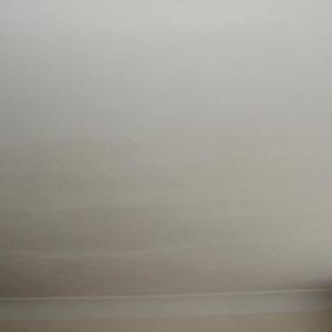

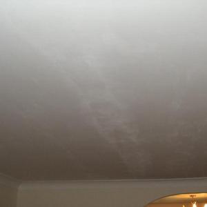

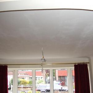

    Thanks to everyone for the quick replies, there was nothing wrong with the plastering, as I did it myself, as I am a plasterer. Looking at the ceiling the rough areas are rough to the touch, as if the ceiling has sucked all the moisture out of the paint. I have attached some photo's to my...

    I had my living room ceiling re plastered a couple of weeks ago, and last weekend attempted to paint it. Apparently it is no longer recommended to seal it with a PVA mix, just apply a coat of watered down emulsion with a roller, so I did. It dried in a couple of minutes, but I kept to the...
