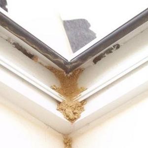

    Hole in uPVC window frame normal??
    Thanks for all the earlier advice. Here is an update: A guy from the window company visited to fix the leak. He said that the inverted cap wasn't helping, but the main cause was the drainage holes inside the frame, which had been drilled too high (as shown in the pic below). He fixed it by...
  4. Inside window frame
    Inside window frame
  5. B
    I wouldn't be surprised. Since they put the drainage cover in upside down, they could have done that too! (Unfortunately, I didn't see whether rain was leaking around the glass because it had stopped raining by then.) Thanks for the detailed advice!
  6. B
    Yes it's a sandstone surround (I think), but the mastic around the window is in poor condition: it looks like the bottom part of it has been replaced for some reason.
  7. B
    Here is a pic of the inside: not much to see except a water stain and the sealant has separated from the frame. But I'm curious why you said the hole is unlikely to be causing the leak? The site manager might well say the same thing and I need to know whether he's right. To me (not an...

  9. B
    Thanks for the ideas. Yes, it's definitely a diamond-shaped window. I've just taken another shot from a higher angle. Does this look right? Any clues about whether it's upside down?

  11. B
    Our house (built 2013) has a non-opening uPVC window which has started leaking. Inspection outside revealed a big hole near the bottom, partially covered by a plastic strip (left). A neighbour's window has the same plastic strip but no hole is visible (right). Presumably the strip covers some...
