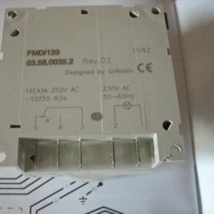

    main combi 30 he timer wiring problems
    i just tried 5 and 3 and in worked in reverse, you said try 4 an3 if this is the case do you mean 5 and 4, because it was 3 and 4 in the first place
    yes there is still a link between 1 and 2
    thats what i thought. thanks for the help. the timer i have has 5 terminals
    yes this is the wiring of my boiler. but the harness for the timer does not plug in there
    this is how i have wired it to the boiler

  9. B
    this is the timer i have http://www.heatingcontrolsonline.co.uk/programmers-timeswitches-c-25.html/boiler-integral-timers-c-25_63.html/digital-timer-for-combi-boilers-p-352.html
  10. B
    i have a main combi 30 he with no timer fitted, i bought a timer and wired it in as follows live and neutral to terminals 1 and 2 the 2 blacks to terminals 3 and 4 and nothing on terminal 5 But the heating is not coming on, i have hot water. i can hear the switch clicking but the heating...
