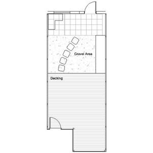

  4. B
    Decking Joists / Support
    Hi, Thank you for your response. The deck is completely free standing, it is filling the far end of my garden and is between 3 sides of the fence. I am planning to put a shed on the far end (smaller square alcove area) - (1830 x 2730mm area). The garden is slightly sloped, but not...
  5. B
    I have put them at approx. 1000mm centres... so these could go further apart? 3no across the width would be adequate? Also are the 2300mm spans on the 100 x 50mm timbers all ok? Thank you for your help. Ben
  6. B
    Hope you can view this....
  7. B
    My images appear to be thumb nail size and un-readable.... Does anyone know how I can post these bigger?
  8. B
    Hi, I'm planning on building some raised decking in my garden and was just after some advice on the supporting structure if possible. I have been looking around on the internet and everyone seems to have their own ways of doing this and seems to be no set way of doing this. I'm planning on...
