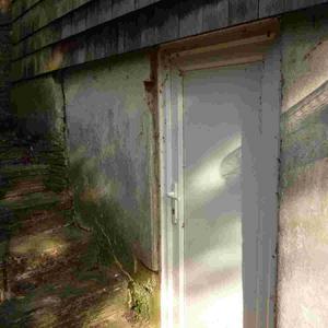

    Patching render on 1930s bungalow - Advice needed.
    Hi all, I need to make some repairs to the render of the external walls of my 1930's bungalow. Repairs especially need to be made where double glazing was installed 3 years ago. I think the top coat is snowcrete(?) and the walls are concrete (with bits of flint and brick). I may be wrong...
