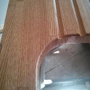

    Best Filler for Oak Worktop
    I cut back, glued in an off-cut and re-routed. The glue line matches with the staves. Pretty happy with the outcome. Thanks for your help. [/img]
    Thanks foxhole. Do you think wax would work to fill this. It's a 1/2" router cutter overshoot. A picture speaks a thousand words:

  6. B
    Hi, Have a nick to the end-grain of a belfast sink cutout - a 4mm deep full height router bit incursion. Oak worktop, currently unfinished and will be finished with danish oil. I'm looking for a filler that will be robust enough for the edge of the sink but will still take the oil - I...
