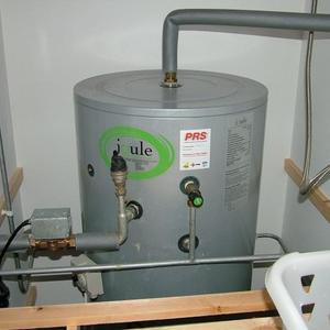

    Thanks everyone. Appreciate all your help and expertise. The cylinder is magnetic, therefore steel, as you stated. The 'corrosion' however, appears to me to be primarily a build-up of deposits on the outside, as opposed to rust. I can chip it off with my fingernail. I can't see where the...

    Thanks. Why do you think it needs replacing? There is the corrosion-like area and probably a very slow leak but the brown material is on the outer surface. Looks like the grey paint is bubbling a little - (top-left of the brown part) - does that mean the whole cylinder would need to go?

    The brown stuff clearly looks like it's caused by leakage, but it's been like that for years and it's dry to the touch.

    Hi - wonder if someone can give me an opinion. I am undecided whether I should pay thousands for a repair, or whether I'm just being scammed. In short - I have a solar-powered hot water system (hot solar fluid gets piped through the inside of an unvented water cylinder). When the water from the...

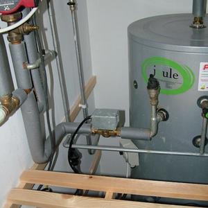

    Thankfully my system seems to be working normally again. I think the stuck valve theory is a good one - seems to have got unstuck again! Thanks to everyone who took the trouble to help. I'll post back if problems resurface but for now, it's all OK. Great forum.

    Thanks. Just found another box (see edit to my last post). Looks electrical to me - no pipes.

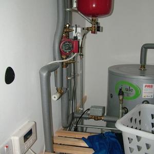

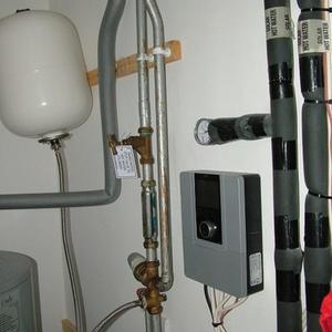

    Many thanks once again. I don't see a second one. I've photographed the whole of the system (see below). The last two images show the tank and the solar panel system, which I don't think are relevant to the central heating system. There is a small box on the piping from the tank (centre of...

    I don't hear anything from the valve when I switch it on or off, except water flowing/stopping flowing. I think I can hear sound coming from the pump. Not sure where I would see the lever - there is a sort of grey slider button on the bottom (you can see it in the photo, through the loop of...

    Thanks very much - sorry for being so vague! I have taken some photos which might help... Thermostat: Honeywell DT90E Controller: Horstmann ChannelPlus H37XL Series 2 Valve: Myson Power Extra We had not adjusted anything - the fault just occurred on its own. [/img]

    Many thanks. That sounds logical. Is there a way I can test this? Do you know where it sits? I am guessing next to the red tank near the heating controls? EDIT: Got it! A Myson Power Extra - little white box. Silly question perhaps - should I knock it with a hammer to see if it frees up the...
