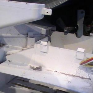

    Thanks, i've gotten it out when i released the belt. It says its a 7.5uF. Should i get the same capacitor. It had actually burst and was leaking. I'll get the capacitor tomorrow and attempt to put the whole thing back together again. When i put the motor back on does the belt go in betwen the...

    Hi, i'll attach a photo so you can see my problem. i don't know how to get any further. I can't get the plastic casing out to get at the motor. Thanks

    Hi thanks for your reply. what does the motor capacitor do. does it trigger the drum to get moving and am i triggering it myself by rolling it to get started. would this be behind the main panel or would it be at the bottom of the dryer where the motor works. Thanks again.

    Hi, my dryer buzzes when turned on, but if i spin the cog at the back of the machine the dryer starts going. this has to be done everytime you start a new load. Has anyone any ideas as what needs to be fixed or done to get it to kick in when turned on. Thanks
