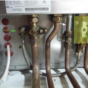

    Vaillant ecotec plus boiler part name?
    Great, thanks again people, glad I joined Ive been searching all Day!
  2. B
    Brilliant - thanks David, this is exactly what I need! Tony said I should replace the left one too (thats also leaking!!) - water dripped out of this when I disconnected the flexi hose - and yes the valve was shut! :wink: Wonder if I can find that too on this site Thanks again
  3. B
    Hi Tony, Thanks for your reply, its tap no 1 which is leaking from the mains supply, this leaks into the filler loop, and thus in turn is leaking into the boiler because that isolation valve has also failed (tap no 2) - causing boiler pressure to constantly rise. When I disconnected the...
  4. B
    Hi, I need to replace part of the filler loop on my vaillant ecotec boiler. Its the part where the mains water enters the system (ive highlighted this in the image) - Even when the grey tap on the isolation valve is fully closed, water is still getting through to the system causing...
