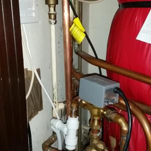

    Constant air in system
    Unfortunately all I have is the following picture showing the pipework in the cupboard. All other pipes are hidden under the floor boards.

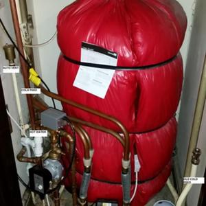

  5. B
    Here is another picture showing an auto vent on the hot water side of the valve. Is this what you refer to ?

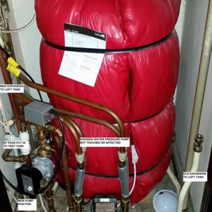

    Find attached a picture of new set up and a picture of part of the old set up, it is a vented system and I have included as much information as possible. some points to clarify. 1. heating works fine if only heating selected. 2. if only hot water is selected the boiler cuts out after a...

  11. B
    Hi, I have recently had a new Y-Plan installed to an existing boiler (Worcester greenstar 24ri), this was due to the 3 port valve sticking and the pump being quite old. Now, when the hot water is on the boiler continually cuts out,however if the heating is on at the same time the hot water...
