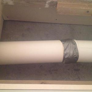

    Flue sealed with duct tape - help
    Thanks, Nige. This is my primary motivation for contacting the factor of the development as I am pretty sure this can't be a one-off throughout the development! I have sent the picture and details this morning. I will keep you posted on what happens. Interestingly there appears to be a Gas...
  2. B
    Thanks. I've recovered slightly! Do you have any idea of approximation of costs to put this right?
  3. B
    Thank you. Immediately upon discovering this I turned the boiler off. I got a huge fright as I've been living here for 6 weeks with no knowledge of this. It's a Vokera Linea 24 boiler.
  4. B
    Hello, I recently moved into a new property (a flat) and arranged for boiler insurance and central heating insurance via British Gas Homecare. The engineer attended today however advised he could not complete the inspection owing to being unable to view the flue as it was in a void space. He...
