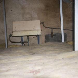

    Corgigrouch, it's dificult to tell as the the second floor has a suspended celling and I can't get to it to have a look without the risk of falling through the celling! I do know that the pipe to the right of the photo goes out through the roof as when I turn the cold feed tap on it over...

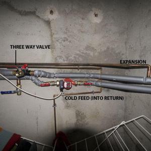

    The rayburn is a solid fuel, we use wood. I think the third photo is an expansion tank, no? With respect, I'm not doing a DIY system Fenchy, that's why I paid someone. I know very little about plumbing other than the basics and what I have read over the last few days on the web (that...

    Thanks for the swift reply... I'm certainly not going to put the unvented tank on the system however could you comment on if the CH system is OK or not as it is set up at the moment. It is actually working and the rads are hot, but is it OK? read something about over pumping and a little...

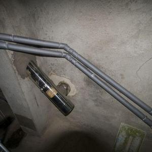

    Hi all, getting very worried... Cutting a long story as short as possible, I Live in France and bought a Rayburn online, contacted a plumber/wood fire 'expert' advertising in a local English language paper to come and install it. There was an old wood fired boiler doing the CH before which he...
