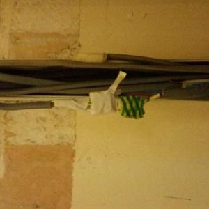

So ive traced out the neutrals on bar 6 (the socket Breaker) they led to the crap joint. i repaired that. still tripped
the sockets did all work when it was wired as follows;
CU out -(6 back sockets) --- Sockets ---- (4 back lights) - return to CU

i took the board cover off the main board just to see if i could see anything loose.
the neutral bar had 2 terminations, so i took the main conduit off above the board....
and found that the 2 wires feeding that breaker - 1 of which had a double choc box / tape joint!!! (see pic)...

Thanks for the reply - the CU Board is split via 2 RCDs RH and LH
LH has the majority of sockets etc on
RH only has 2 breakers (water heater + Glasswash) both biggies for added load.
the board trips on both RCDS when load is applied to the circuit im having trouble with

HI - wondering if you guys can help / shed some light.
i took over an old shop in a really old building - i doubt much had been done electrically since the 70's and the prev tennant was a very bad diy'er!
