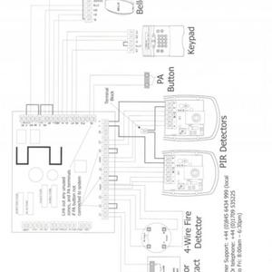

    sterling10lcd
    You are a rock-star....thanks.......it was reversed pos and neg at the pir's......couldn't see it for looking at it.......magic thanks.........got another question now....lol.......see the attached documents............for the internal sounder it says connect to BA / SPK but I do not have these...

    The panel is Sterling 10-8 Zone - Sterling 10 PS10LCD and the PIR'S are Pyronix MEQ blue quad PIR detector.

    The terminations in the PIR are 2 for tamper, 2 for aux and 2 for N/C, 1 being N and the other being C. You do not have an option for N/O. Then at the panel you have 2 terminals marked zone which I terminated the 2 cores into which I had N/C at the PIR. It's a strange one. Thanks for efforts...

    No joy, I took the 4 fuses out and re-checked, all ok. 2A Battery Fuse 2A AC Fuse 1A Aux Fuse 1A Bell Fuse I am getting approx 14v at each PIR and the tamper operates, I am just getting an open loop at pir on the N/C terminals, I linked these out to prove the cores ok and they were. Strange...
