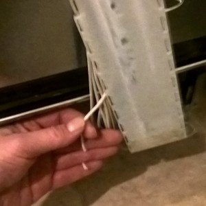

    Diplomat ADP8322 F3 Fault
    My F3 fault turned out to be a broken wire (at the point it flexes when the door opens). The broken wire supplies power to the water heater. Removal of the front, metal face-plate from the door (below the white plastic panel ) reveals the wiring loom which runs from the control panel to the...
