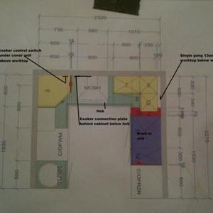

    Thanks i think this sounds like then neatest solution as i really wanted to use the cooker connection which is not being used by anything at the moment. I have another question, currently i have a hob which is gas but has a battery operated ignition. i will be getting a new gas hob in the...

    Hello I hope someone could kindly give me some advice. I have a small U shaped kitchen, where the gas hob is located, to the left is a cooker socket with a cooker plate behind the cabinet the hob is fitted to. Nothing is using the cooker connection. I have bought a new oven which the...
