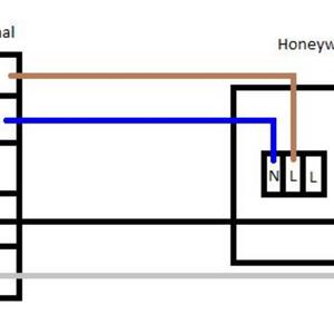

    Hi, Managed to get the whole ground floor working. I take all the valves and heads off and started again room by room. Upstairs though i cant get to work :( Radiators aren't getting warm and HR92's arent shutting the valves off correctly.

    Hi I took the hr92's off , twisted the head anti clockwise so that radiator valve was now fully open. I then re attached hr92 which then performed it's cycle .. Requested heating on via the controller .. Hr92's adjust ok , relay clicks on , boiler fires up .. Leave it for a while and...

    Hi, Think i have found the problem. I have got the controller and relay to talk. Set the heating to come on via the controller, relay activates (light goes green) boiler comes on. I then use the quick action button to turn the heating off. This is where i believe i have a problem. When...

    The BDR91 seems to receive a signal to turn on when demand is received from the zones. But when the demand is not required the relay does not click off, the green light stays on. I will try the reboot option later.

    No joy :( Factory reset all components (bdr91, controller & Hr92). Ran through the guided config and still the relay wouldnt turn off the boiler via the controller when the quick action 'Heating Off' was pressed. I used a piece of flex to manually contact A & B and this fired up the boiler...

    Hi Simon, Thanks for the reply Yes i pressed the button on the front for 15 seconds. The BDR was binded as a boiler relay. No HW pack as its a combi so i presume i dont need one? I cant remember if used the guided config or not. I will reset all items to factory settings tonight and...

    BDR91 wiring diagram.
