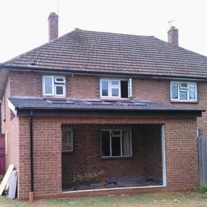

    Pitched roof extension, tiling issues
    Thanks for all your comments. The builder did say that the tiles between the velux windows had to be sloped inwards, to allow water to drain away from the frames. In terms of the wall construction, I can confirm that engineering bricks were used, up to DPC. BC have done their initial...
  2. C
    My builder hasn't tiled the sections of our new pitched roof extension that sit beneath the windows of the existing house. He said the pitch of the roof would not allow for tiles and flashing so we're left with what I presume is the membrane exposed. Is this normal or will it result in leaks in...
  3. C
