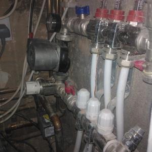

    Plz help Boiler & UFH pump not switching off - timer off
    No luck. Tried once more. For now, I have lowered the boiler flow temp to 38 as I think the water in the circuit is higher and the boiler isnt running at the moment, but the pump is. There is some kind of pump/fan running inside the boiler it seems. I am btw in Harrow
  6. C
    I have switched it off 2 times already. Do I need to wait for specific time before switching it back on?
  7. C
    You can see the valve underneath the pump
  8. C
    I do see one on the UFH circuit underneath the pump (looks like its on the return flow), one on the rads pipe going upstairs, one near the water cylinder. Havent seen the 4th one but will check. Is there anything I can check on the UFH valve to confirm if its faulty? I also have switched...
  9. C
    Hi all I have a Vaillant Ecotec 624 System boiler with uniSTOR 210L cylinder. also have a 3 channel hortsmann programmer which controls: a- Hot Water b- Heating Zone 1 - Radiators downstairs c- Heating Zone 2 - Radiators upstairs (both radiator zone are controlled via 2 separate...
