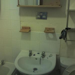

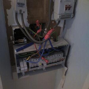

    Dodgy workmanship, Bad installs, Bodge jobs. More Pictures
    Heres a couple of my own.. Can you spot the problem? Heres another one where i had an empy house to check out, the previous tentant stripped out the elec meter and taped the main feed together with the ring, lights hot water and shower, and same with the neutrals, all just taped together...
