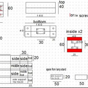

    ok i think ive posted a photo of my tv stand design in my albums it may be difficult to follow as im not a designer... it is just to help me if it has worked please tell me if you think it is a viable ... will it hold or will the wieght be too much for the screws and smaller pieces.... i...

    thanks again for replies so the plan i have for my tv stand includes 4 sleepers we talking about 150kg or so ? at that weight will screws still hold in place without snapping ?

    hello forum. I am planning on building a tv stand, a coffee table and two lamp stands using new untreated oak sleepers of size 2400mm x 200mm x 100mm. I have made some designs to follow however im a very amateur DIY'er and i am seeking any and all advice. I work in a school so I have...
