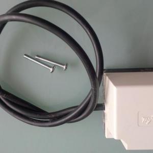

    baxi megaflow 32 he overheating fault
    Hi, Part arrived yesterday (£33.84 delivered). 15 minutes to fit, 20 minutes testing and all is as good as new. Thank you all for your input. KR P.s. Very happy and a bit hot!! :D
    Hi just spent the afternoon checking all of the external controls with my electrician friend. Everything seems to be in order apart from the CH actuator which managed to keep the boiler on even with the timer in off position, we removed it and even with with the front panel off the timer the...
