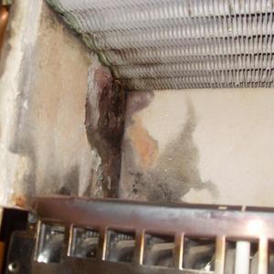

    Many thanks for your help twgas. Cannot understand why it felt dry after boiler turned off for a couple of hours. Could it just leak when boiler is firing up. ???
  2. C
    Vokera Linea 24 pressure dropping
    OK i have uploaded photo. I would very much appreciate anyones help on this please.
  3. C
    Thanks, but the return valve lever is snapped so not easy way to isolate boiler. I have take a picture but not sure if you can upload onto this site.
  4. C
    The pressure gauge on my Linea 24 combi is losing pressure over period of a few days. (From 1.5 to 0.2bar) There are no signs of leaks and the Safety valve discharge line is bone dry. I have taken the covers off boiler and inside the combustion chamber at the rear the side insulation panel...
