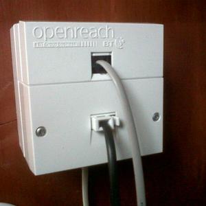

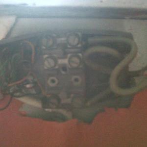

    Hi there im in need of some help Currently the drop wire for my BT line enters my house in my sons bed room which connects to a junction box from that junction box is a very loooooong tin extension cable that runs the length of my house to the downstairs hallway beside my electrical cupboard...
  7. junction box
    junction box
  8. drop wire
    drop wire
    pic of the junction box were my drop wire enters
