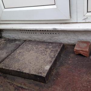

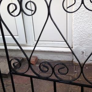

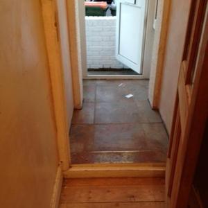

    The porch area is timber under the tiles

    I've posted new photos of the ground level bay area, as requested. The builder is coming today so we're going to ask him to remove more floorboard from other areas of house you've suggested to investigate further. Hopefully we can post photos of these this eve. Update on 3 damp...

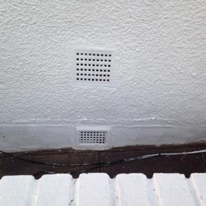

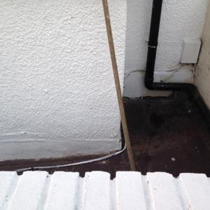

    Thanks john I will try answer as many of your questions as I can later today. To begin with,we have just managed to lift 3 of the floorboards and looked underneath. I have added photos to the album of this area. The air brick was totally blocked by rubble etc... Absolutely no ventilation...
