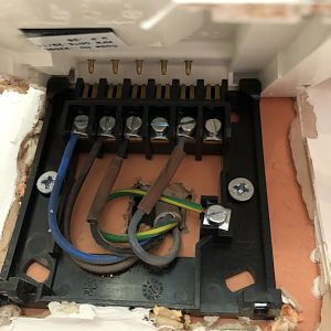

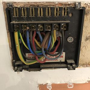

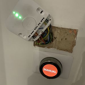

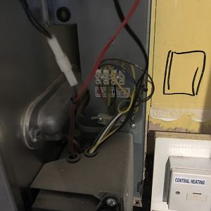

There’s no cable going to terminal 1 - I think it’s just the angle off the photo. The red cable is actually going to the L terminal.
I have my connections incorrect, and have since modified as per the Tempus diagram which you attached. I have powered back up and the...
Here are some photos of the before and after install...49CE5157-C5DE-4CFF-8DAE-3CE3A3E49500 by Chaseterrace posted 8 Jan 2019 at 7:57 PM82B1E26E-07BA-435D-80B0-E4B2A0957882 by Chaseterrace posted 8 Jan 2019 at 7:57 PMB6EB2C5C-300B-4020-88DD-1DC5C8871E00 by Chaseterrace posted 8 Jan 2019 at 7:57...

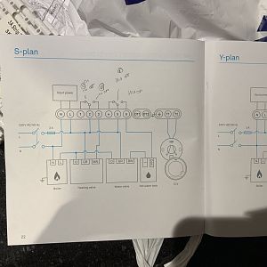

Hi,
I have purchased and attempted to install a Hive Gen 3. The existing set up was a thermostat (Drayton Tempus 7) and a WR 1 thermometer. Looking at the existing install and the wiring diagrams with the hive booklet I have assessed that I have an S-Plan configuration.
So I have powered...
