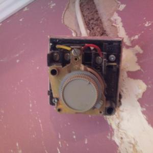

  4. C
    New Thermostat wont work
    This was the old one

    Hi, I'm trying to fit a new thermostat but it wont work. This is the third one I've tried but they either work at random or as this latest one is doing the heating constantly stays on even when it's turned down to the minimum temp. It is a Honeywell DT90e thermostat with a Potterton EP4001...
