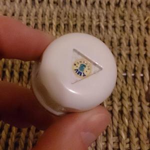

    Bath tap nice and hot all these years on. Thank you.
  2. ckracer76
    Bath hot tap only luke warm, unable to run a hot bath?

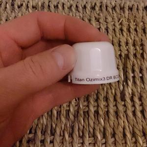

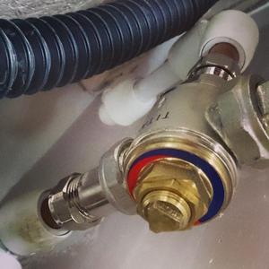

    Got it! Thanks Armo74 The cap's triangle shaped indent is a key for the bottom of the mix thermostat valve. The triangle cut away matches the triangle shaped valve adjuster. It was so easy to do. You just simply turn the valve in the direction of hot or cold. Genius! I turned all...

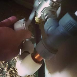

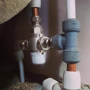

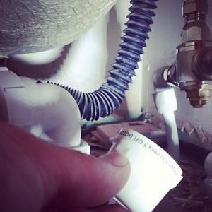

    I've taken some more pics from underneath
  4. ckracer76
    I see so this is a mixing thermostat. I'm guessing the reason the hot water is luke warm because it's adding cold water to the hot feed to regulate the temperature. I tried turning the cap but it just swivels freely so it's not a switch as such. The cap came off in my hand. It has...

  6. Titan Ozimix3 cap top
  7. Titan Ozimix3 underneath
  8. Titan Ozimix3 cap off
  9. Titan Ozimix3 cap
    Titan Ozimix3 cap

    Thank you all for the prompt replies to my query. Interesting to hear bath temp can be regulated. I removed the bath side panel as suggested to reveal the water pipe work and was greeted with what looks like an upside down radiator cap. I notice that the hot and cold feeds are linked...
  12. Titan Ozimix3 mixing thermostat

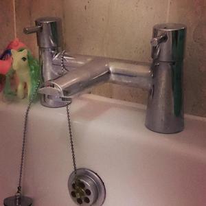

    Pictures of bath and tap
  14. ckracer76
    Hi We recently moved into a new build only to find that the bath hot tap can only run luke warm? We are unable to run a nice hot bath. It's strange because the sink tap will run so hot it will burn your hand? Same downstairs and in the kitchen, all run very hot. Can I adjust the...
